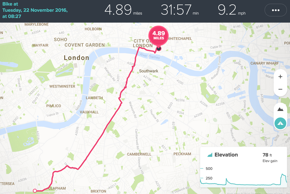

This device is confusing...I again give you 2 identical bike rides which appear to have recorded identical GPS tracks and one is literally 2 miles out (for reference Strava calculates the route pretty much identically at 5.4 miles)!
21 NOVEMBER
22 NOVEMBER
In terms of the settings on my iPhone:
1) Cellular data is on and always has been.
2) GPS Background App Refresh is on for both the phone and FitBit.
3) Location Services are “always on” for both the phone and FitBit.
Heim I have reported the same problem.  The GPS track looks apparently to be the same on the map.
However, try to zoom in cose to see the details on a street level.  I discovered that there are small inaccurancies in GPS positions ( +/- 10 m ) and Fitbit is simply drawing a straight line between the individual positions.  There is no well defined direction.  When adding up all the incremental distances it gets very wrong.  This is what Fitbit replied to me complaint:  However, I have the same problem regardless of starting the excersice on the Charge 2 itself in Run or Walk mode or on the Fitbit App on my iphone.
