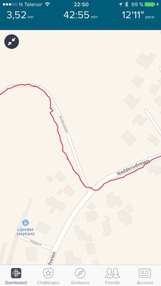

Charge 2
Here is the another walk on the same roads.
This is Charge 2 but with an upgrade of firmware to 22.48.14 and iOS 10.2 and Fitbit 2.31
As you can see it is more smother but not as smoth as Charge HR. Distance is now 3.52 km aboy 0,3 km too long.

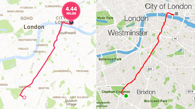

Below you can see a comparison of the results from FitBit (left) and Strava (right) for the same commute (I recorded the commute with both the Strava iOS app and also the FitBit Charge 2 using the button on the FitBit):
01-13-2017 02:22 - edited 01-13-2017 02:24
I agree with your thinking that there's something wrong with the Bluetooth link between the GPS device (smartphone) and the Charge 2.
In my scenario I use a Charge 2 when cycling to and from work and my verified 5.4 mile commute was variously reported by the Charge 2 as anywhere between 2.5 and 6.5 miles - crazy - but I think the fact that I kept my smartphone in my back pocket was a contributory factor and now it is on my handlebars and I get much more consistent results:
However, even though I now don't get the completely weird results of 2.5 miles for a 5.4 mile commute (verified in both Google Maps and Strava), the FitBit is still regularly off by at least half a mile.
As you can see, FitBit is still recording the distance short!
