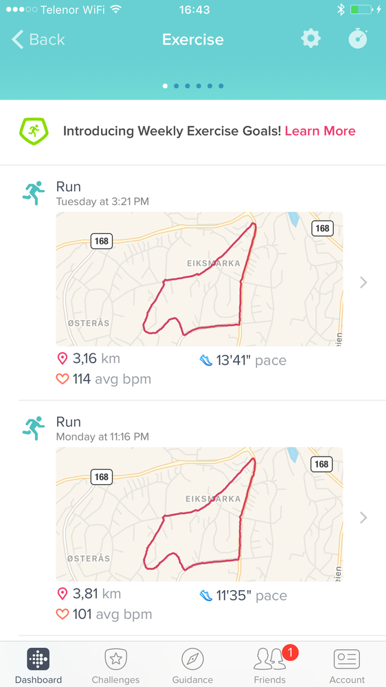

Today I completed the last test of iphone6+ and Charge2.
Charge 2 was paired up with iphone6+ and the RUN was started manually from Charge 2.
Same route as before and the phone was in the same pocket as before. Total distance 3,16 km and no wobbling as before. True distance is about 3,2 km.
Yesterday I did the test on iphone7 after reinstall iOS10.2 as new cleaning up all setting as a request from Apple Support. The RUN was started from the App and I had cut Bluetooth to Charge2 to avoid interference.
Unfortunately it did not help. See the results below. 3,81 km and wobbling....
Attached is the total route walked comparing the 2 tests. True distance is about 3,2 km
To sum up the testing on iphone6+ and iphone7
Same routes all tests. True distance about 3,2 km.
IPhone 6+
3,2 km Fitbit Charge 2 disconnected the blue tooth link to iPhone. Start/stop on App. Mode Run. No SIM - No wobbling 15. Jan 2017
3,16 km Fitbit Charge2 paired to Iphone6+. Bluetooth link active. Start/stop manually on Charge2. SIM inside. - No wobbling 17. Jan 2017
IPhone 7
3,81 km Started on App. No active link to Charge2. (After reinstall IOS10.2 as new) 16. Jan 2017 Mode Run
4,31 km Active link to Charge 2 but left Charge 2 home and took out SIM - start from App manually (Prior to reinstall as iOS10.2) Mode Run 15. Jan 2017
Charge 2: 3,87 km (start/stop on App - tracker on arm) 13. Jan 2017 Mode Run
Charge 2: 3,52 km (start/stop on tracker) 11. Jan 2017 Mode Run

1) I found the Fitbit Charge 2 distance accurate enough when using iPhone 6+, both when starting the Run manually from the App and from the Charge2 tracker itself. No major wobbling effect found. Deviations of 20-40m from a true distance of about 3,2 km is not a lot. It is easy to cut a few corners as well during walking and you can loose 10-20 meters.
2) For iphone7 (at least my phone) the distances are always too long. Routes are wobbling and have a lot of variations on the same track as well. I have found more fluctuations in GPS accuracy on iphone7 compared to iphone6+ when testing on App Maps and App GPS Status. If the satellite signals are not ideal as when leaving the phone in the window of your home, this is easy to notice. The components in the Apple phones vary between models so even with the same iOS operating systems the BIOS will differ between phone models so there might be so diffrences on values.
3) I tested outside yesterday with both phones in the palm of my hand walking a few hundred meters. IPhone 6+ had excellent fix of consistent horizontal Accuracy of 5 Meters and vertical Accuracy of 3 Meters.
Iphone7 had Excellent fix in the range of 6-8M and vertical fix of 8-23 Meters on the same walk. This is ok and explains probably why I get fairly good distance results when driving the car with the phone is in the front window or going for a walk with the phone in the top pocket of my bag. Not too many wobbling effects on the track then. Probably the GPS signals to the phone in my pants or jacket are not that great and stable, This affected my iphone7 more than iphone6+.

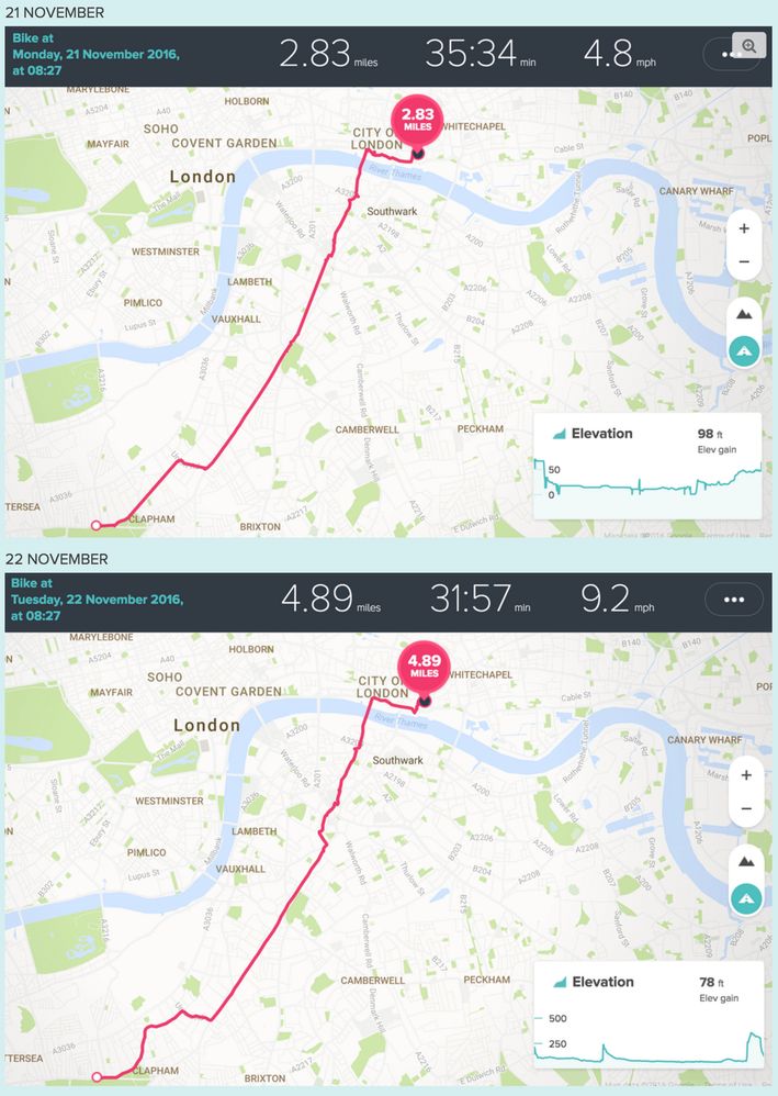

I think the limitation of your tests is that in both cases (iPhone 6 and iPhone 7) you are only using the FitBit app to record the distance. What your tests do show however is that within the FitBit app there is a difference in how FitBit communicates with an iPhone so is that the source of the problem?
I have regularly run and biked exactly the same route for the past 2 years and with both phones (I used the iPhone 6s previously but now use the iPhone 7) the Strava app for iOS reports the distance accurately on a very consistent basis.
The FitBit app on iPhone 7 and using a Charge 2 is very inconsistent - although the GPS tracks seem to be relatively accurate I get wildly inconsistent distances. I mean crazy inconsistencies...look at this:

Yes I agree, iPhone7 and the combination Fitbit Charge2 is a disaster....your track looks the same on the map until you zoom in very close. Large variation in distances comparing the same exercise over time.
By the way I had some problems too with some navigation maps to like NAVIGON Europe on iPhone 7 with the first release of iOS 10....have not checked out 10.2 yet. The car position was not moving in a continuous motion on the map while driving as it used to do... more moving stepwise and dragging behind my position on the road.
