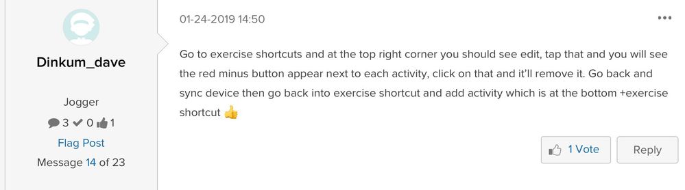

This has worked consistently for me - usually I can change interval times 2 or 3 times, then it stops working again, I delete that shortcut, put it back, and all good for a few more times.A763B5AD-5769-4050-A2DD-A17384975E1A.jpeg
Hi @MarreFitbit I just tried following the steps you outlined to change the interval timer times on my Charge 3, but despite syncing it doesn’t change on my Fitbit, it immediately switches back to the default on the app.
