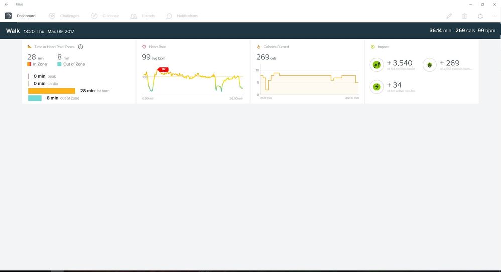

To track my walks:
I "start" the exercise by selecting the walk, making sure the Charge 2 recognizes and links with my phone GPS
Then walk
Finish the exercise by "turning off" the walk
Make sure the Charge 2 syncs with the mother data base and the phone
Go into Dashboard
Select the exercise
It displays the exercise with a little map
I've another app "Simply Walking" which does a great job of displaying GPS tracks on maps and satellite
imagery.  It also tracks steps, but doesn't do heart rate.
/edit -
This should work with any activity linked to GPS.

To track my walks:
Then walk
Go into Dashboard
Select the exercise
/edit -
