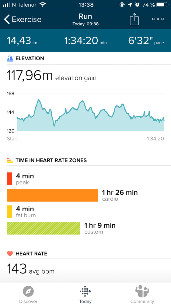

I might have found a (or another) workaround (tried with both the tracker and phone, but got two workouts logged).
Today I only used the tracker - did not start an activity in the app on my phone.
After syncing, the acitvity showed in the app, with the heart rate. I also noticed it shows the elevation - this was new to me (and welcome :-)).
(and no, I will never be a fast jogger 😉
Did (of course) not get voice feedback, but I used another app for that purpose
