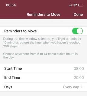

Hi Silvia,
Thanks for your answer.
These are my settings:

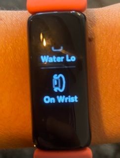

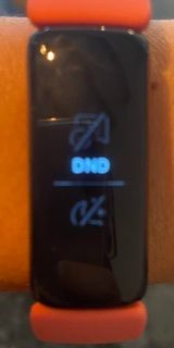

The sleep mode is also off:

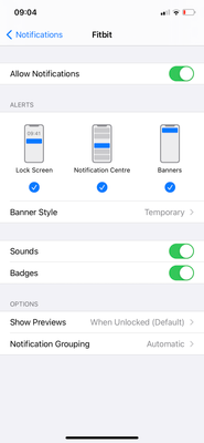

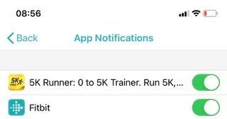

And the notifications are on for my device and my phone:
And I sill do not get any notification from Fitbit or 5K runner.

It finally works! I have restarted my device connecting the charger and pressing the side button for long.
This action turns the sleeping mode 'ON'. I deactivate it and now I get the 'Remain to move' notifications and also the '5K runner' notifications.

I did not change the settings.I restarted it again after notice that it did not notify me. This time the "Do not disturb" was "on" after the restart (no before). I turned it off. So, the settings are exactly the same as in the pics.

Hello @Luzmo84 and @SilviaFitbit I have the same problem, I noticed that dnd mode activates itself when wearing the fitbit... A "long press" on the sides makes pop the dnd function... then an unwanted smooth touch (clothes or...) activates DND mode !! How to change that behavior ?
If we can choose what the "long press" does, we can avoid that problem !
