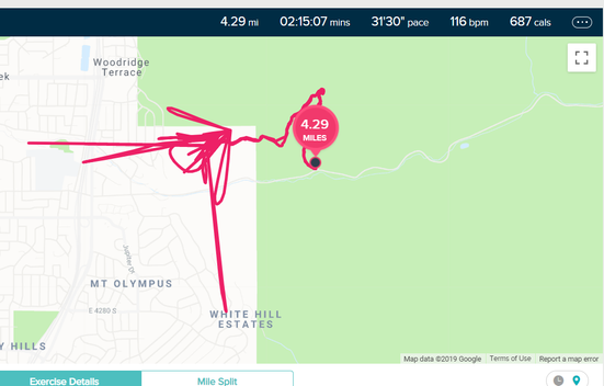

Keep hoping things will get fixed but no such luck. Still having trouble. I am now on a replacement versa and does the same. my hikes keep looking like the picture. but every other app I use shows them correct. Versa just wont keep a connection.
