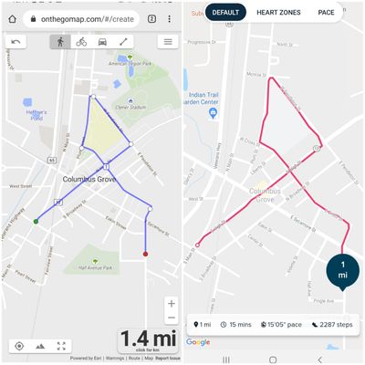

Picture says more than thousand words so... picture first.
How can it be that the same lap is measured THAT wrong. It is 1,27 km difference which is BAD. Both lines run on the same road so it can not be just "difference". Step count is the same and also the time. Which one can I trust at all? It isn't the first time it has happened (at least once more).
FitBit app is up to date. My Versa 2 is up to date.

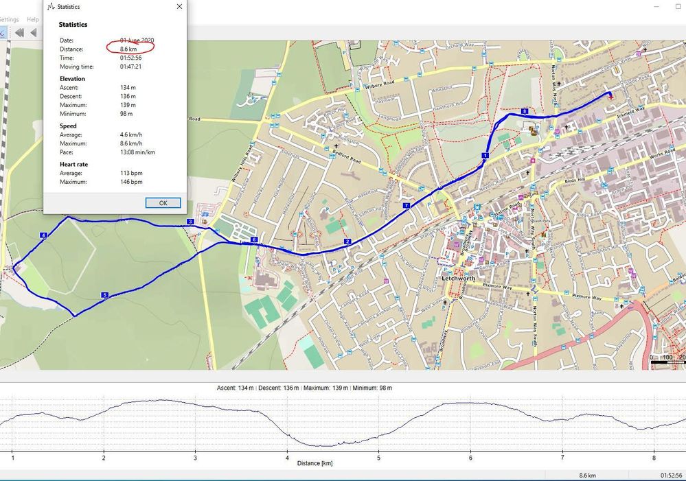

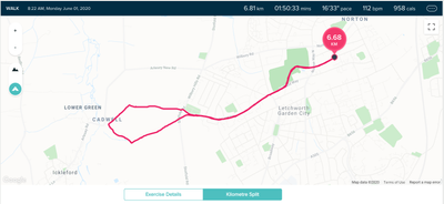

Had the same issue on Charge 3 (having it replaced under warranty which I am giving to my partner) and have an open ticket regarding this issue. I bought the Versa 2 and am still having the same issue. It HAS to be the app. I have used two different FitBit devices, Strava, Komoot and OnTheGoMaps. FitBit is always the one that is a mile out
- Model/brand of the phone you're using
Samsung Galaxy S10+
- OS of the phone
Android Version 10 (2.1 UI)
- When exporting the Fitbit GPS data (TCX file), is your distance accurate?
Yes. The map shows that the route is 6.6miles which is accurate. The Fitbit app shows that this route is 5.1miles.
- When finishing your run/walk on your watch, do you see the same information (when checking the summary) on the watch than on the Fitbit app?
Yes.

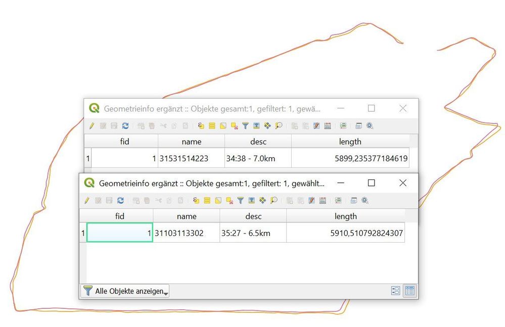

Since i started to use "connected GPS" with my Versa recently, and, of course ran into this problem, i gladly add my Report.
Google Pixel 2
- OS of the phone
Android 10, latest build from May 5th.
Yes. I also converted the TCX File to GPX and checked the distance of two tracks in QGIS and the distance of the recorded track is pretty accurate (about 5.9 kilometers), while the watch and FitBit app values are off by 0.5-1km.
More or less, yes. It seems that the value in the Fitbit app is "corrected" a bit, but nowhere near the correct distance.
- As you all are on Android devices, confirm you've done or checked the following requirements:
The requirements are all okay, as i said, the recorded GPS track seems correct.

I also want to show the difference here between the tcx data exported from Fitbit and the data that the Fitbit app shows.
How can this be allowed to happen? Have I just bought myself a tracker that can't even track the correct distance?!?! I'd laugh if I hadn't spent so much on it! 😞
