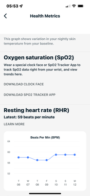

Hi, heather. Sorry if you covered this, it's just confusing and i've googled it every which way. So, i CAN'T track sp02 blood oxygen UNLESS i use an sp02 specific watch face? (and sleep with it, you said)
I ask this because:
A) i don't care about seeing it on the watch so much as i want to see it show up on my compatible 'Sleep as Android' sleep app but even though my watch is connected and successfully uploading HR data it's not registering any blood oxygen.
B) i really don't like any of the sp02 watch faces 🤷🏾‍:male_sign: and I definitely don't want to have to bother with changing my watch face every night before I go to bed..
Please help if you can! 😵💫🙏🏾
@portzblitz Yes, you need to use an SpO2 specific watch face. Here is what my Fitbit app tells me when I go into the Health Metrics tile.
Heather | Community Council | Eastern Shore, AL
I've done extensive testing on this issue.
What I've uncovered is that you ONLY need an SpO2 "FACE" to view the SpO2 numbers on the watch itself (when it actually works) .
When SpO2 does work (and it's still intermittent), when syncing the watch, the app DOES PICK UP THE DATA!
I no longer WASTE MY TIME switching faces every day just to check my oxygen.  It's just a pain to do so all the time.
So now, I leave the watch face on to my favorite face.That face does NOT support SpO2 and in fact, is a face that one can make using special software.
However, when I sync the watch and look at the Health stats, when it works at all, THE DATA IS THERE!
Sadly, many people believe that you NEED to have an SpO2 face active in order for the data to be captured and synced.  That, is actually not true.
It's ONLY required if you want to display this data on the watch's screen.
Hope that helps.
