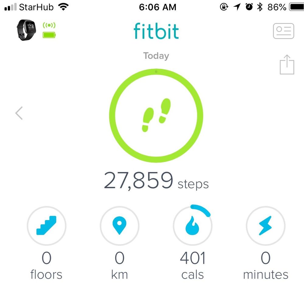

I too have problem of steps counting with my versa. First day after I got it (last Thurs) it recorded over 1600 a while later after it was fully charge although I didn’t wear it. Wrote to Fitbit and it’s customer support team advised me to wear it to monitor its progress. Wore it whole day yesterday (Fri) and the it hit few hundred steps although I just walked for few steps. I have turned it on and off but nothing changed. Finally  I took if off and put it on the table last night before going to bed and it hit beyond 27000 steps this morning it’s own when I checked. I wrote in to Fitbit again for an exchange and yet to receive reply. I’m quite disappointed as this is the first Fitbit I own after reading so many good reviews about it. Anyone knows how to go about doing it to request for exchange?
