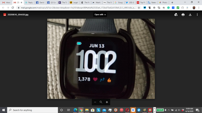

Marla,
Thank you for taking the time to address this problem. I have been able to get my display to work for a few seconds at a time. And, as the technical support said, the Versa is fully charged. (She noted that device had synced on Saturday night.) The date on the display is Saturday night. (Though I still get an intermittent image of a red battery that says 0%)
Unfortunately, the display turned off before I was able to complete the factory reset.
I will check out the articles you sent links to later.
Thank you for responding.
