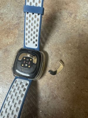

Metal trim on back of Sense 2 fell off
Has anyone had this problem and is it safe to use superglue to fix.  See pic

I woke up this morning and one of the metal plates was sticking out from behind my Sense 2. I have been told there is nothing that can be done because it's out of warranty. Clearly it is a manufacturing issue as so many others have had the same experience. I have never gone in water of any type while wearing it, despite the fact that Fitbit states it's good up to 50m. Has anyone been successful in stating their case? It will be the last time I purchase anything from this company if this is how they stand (or rather don't stand) behind their products.

I just put it back on with superglue, taking care not to get any of it
outside the two circular areas where the original glue was. It's worked for
me perfectly since.

I decided to use gorilla glue on the first piece that fell off, since I was out of warranty there was no risk. It worked! Then two weeks later the second metal piece fell off so, I did the same thing. Again, worked like a charm. How long will it last? Who knows but I’m happy my watch still functions. However, I cancelled my premium membership because I will not give this company another penny.
They keep making defective products and don’t care about their customers.
NOTE: Be sure not to put any glue on the sensors. All you need is two small drops anywhere else on the metal where it isn’t going to connect to the sensors.
