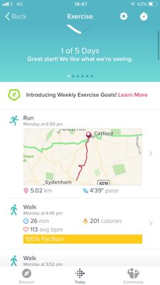

  • Exercise tracking, when started from within the app, does not appear to track the heart rate with the activity (see screenshot one, where the heart rate is missing below the activity. It is also missing within the activity page). Many users prefer this method as it allows them to use the voice cuesDEF72EFF-A396-4A3D-A471-4C8D1CFD5F8E.jpeg

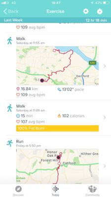

  • When tracking is started from the Fitbit device itself, the heart rate is tracked and passed to the activity on the app. (See screenshot two, where the average heart rate is visible below the activity). This method does not provide voice cues11EED73F-5574-49A0-B6A7-7FF011DD1FBE.jpeg

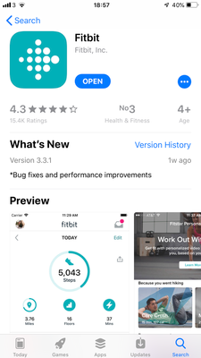

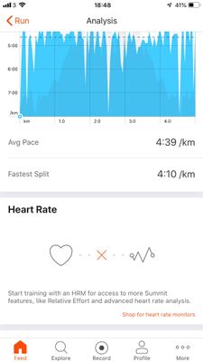

  • When tracking via the app, the heart rate data is also not passed to third party connected apps, such as Strava (see screenshot three)F1B2A813-8FA2-4309-9504-48D579711A33.jpeg

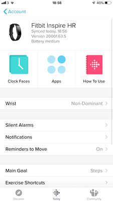

See also the the screenshots below regarding my Fitbit app version (displayed on the iOS App Store with no update available, on iOS 12.4) and Fitbit Inspire HR software version.
