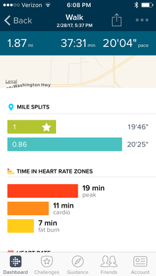

At the risk of jinxing it, I logged a walk this afternoon and it appears to have synced distance and pace correctly (for the first time since 2/22):
Not sure yet if the issue is truly fixed, or if this bit of accuracy is a fluke, but I'll take it.

@tracey2 you got lucky and/or experienced an anomaly (like you said: a fluke).  I usually log 2 to 3 "workouts" A DAY, but for the past week only 2 workouts have logged a distance even close (ONE was right on) to the milage that I actually put in.  It would, however, be nice if what you experienced would continue Smiley Very Happy
