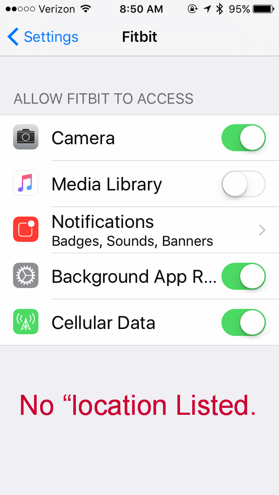

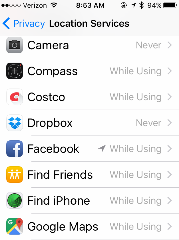

Having same problem. Been happening 3-4 weeks. Was trying to reset my Fitbit now my steps are not showing on phone.  Synced and powered down phone
1. What type of iOS device are you using?  iphone 6
2. What iOS version is your device running (ie iOS 10.2, iOS 8 ,etc)?   ios 10.2.1
3. Were you using the Apps GPS, Surge's built-in GPS, or Charge 2/Blaze's Connected GPS to track your workout?   Using Charge HR.    Fitbit is NOT listed under Location services.   It's not listed under the app itself either.
4. Does force quitting and reopening the App help?  No.
