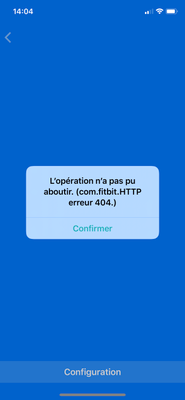

I’m getting a error 404 when I try to add my device

Luc
I found a solution by myself
Turn off the Fitbit app
Change your phone language to English
Go back to the app and install Aria Air . It will work
Change back your phone language to French
It’s a problem with French Canadian version of the app
No. I returned it.
WoW excellent thanks for the help everything works fine now.
Hi yes it’s up now I had to change the language of my phone to English and it work right away once completed a turned it back to French and everything works fin
