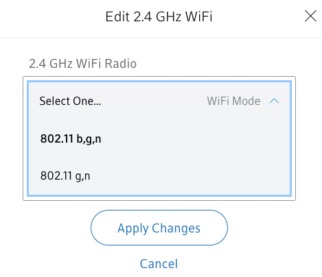

I only have the option for "b, g, n" or "g, n." It was worth a shot though!Screen Shot 2018-03-13 at 7.43.05 AM.png
The original Aria only uses the "b" channel so you have to go with that. What I've done is you buy an old wifi router at a garage sale and I've used it to setup a "b" only network with a separate SSID - the "WAN" connection on this old box is plugged into the house wifi router LAN side and it's worked solid. You can find old routers very inexpensively - nobody wants them any more.
