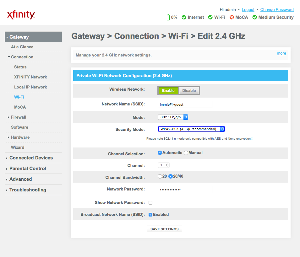

That sure is odd because my 2.4Ghz network specifically says 802.11b. If Fitbit would tell us the darn specs, maybe we could make this work. I've tried every channel as well. I'm about to break out my enterprise network equipment for this crap but it's not worth my energy. I'm using this (Wireless Gateway 3/TG1682G because I was Arris certified and also I am lazy. My $30 Renpho seems to sync via BT to Apple Health happily.Screen Shot 2019-08-02 at 3.11.17 PM.png

I SOLVED THE PROBLEM. It was never a Wifi problem, I've changed nothing about my 802.11b 2.4GHZ guest network on an Xfinity modem. Even though I did a hard reset on the scale, removed all users from the the scale via Fitbit.com, and removed the scale from my account through my Fitbit.com dashboard, there was an iPad in the house with the FitBit app on it and it had the scale listed. I removed the scale from the app on the iPad and the scale magically worked on my Wifi. I AM BESIDE MYSELF.
