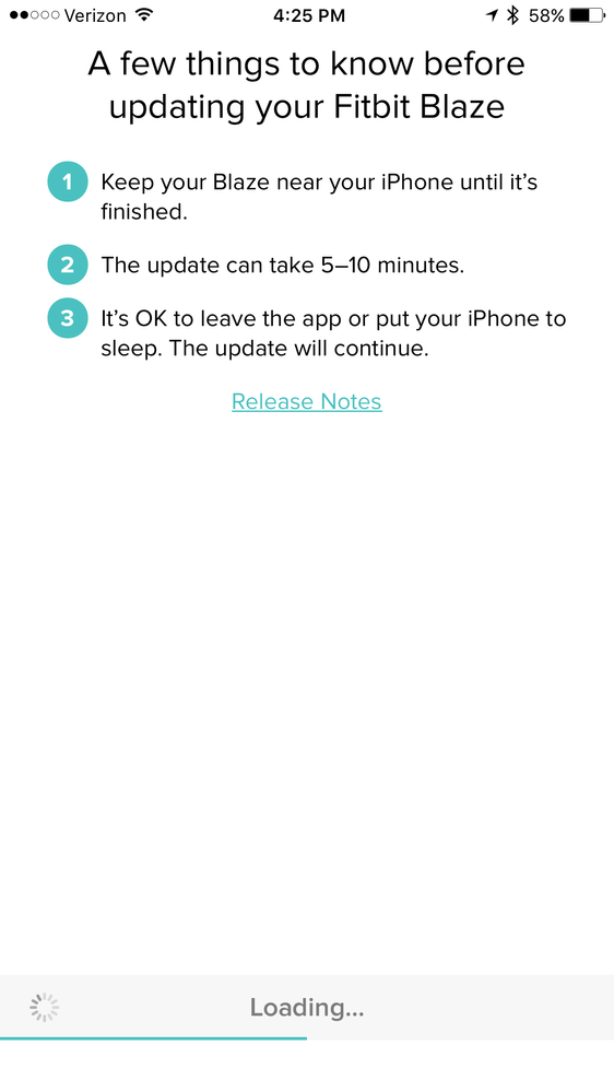

I have tried updating the software on my Blaze several times, but I keep getting to the same point and it stops. IMG_1893.PNG
