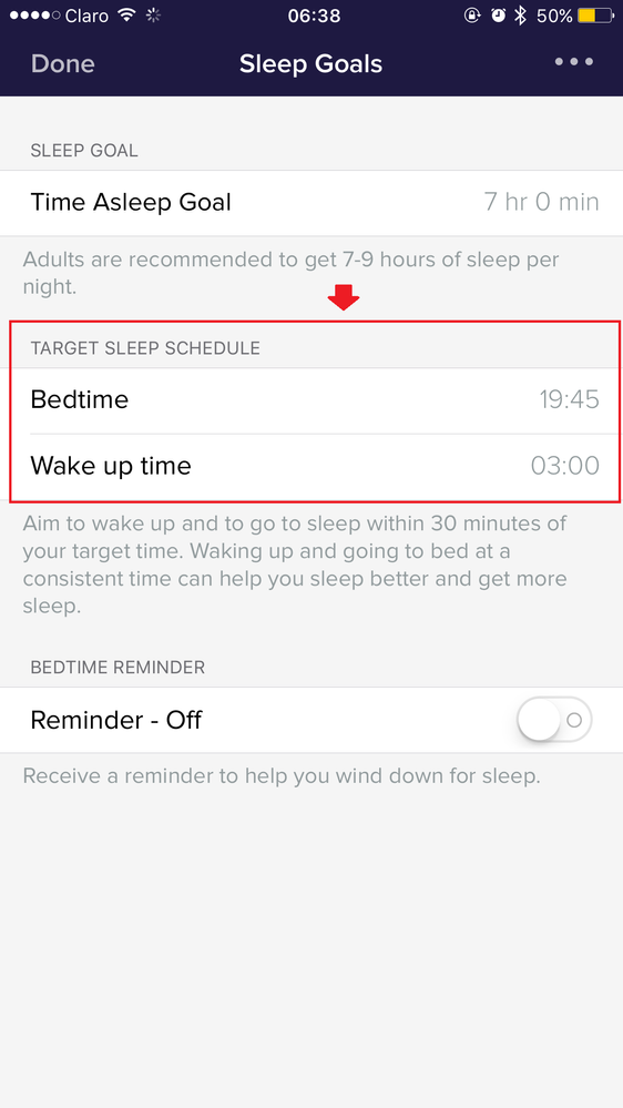

It's nice to see you around @Jd1682! Thanks for sharing me the picture of your sleep data log.
I have taken ownership of your picture to make the example (sorry).. but let's see what I got. This is the picture you posted:
You're in the screen that says "Sleep Schedule" as I've marked in red, you're on the middle white circle which is not your sleep data, is the schedule chart. Another thing I noticed is that your tracker is tracking your sleep as you can see in the arrows next to Sun (6 hr 39 min) or Sat (2 hr 23 min).
I have replicated this with my data and I got the same as you, but in this case I do have a sleep schedule set.
In this case I have information in my "Hours slept" chart as I'm in the first white circle and not on the sleep schedule.
If you want to get data on the "Sleep Schedule" as I do (my picture above is showing the schedule I set).. please follow these steps:
Setting a bedtime reminder can help you maintain a consistent sleep schedule by prompting you to unwind 30 minutes before your bedtime target. You can set a bedtime reminder without setting a bedtime target.
If you turn on the reminder, you'll receive a push notification on the mobile device paired with your tracker.
Most people want to receive a bedtime reminder on work or school nights. If your schedule is different, you can edit the days you receive a reminder.
If you're not getting sleep data from last night, please re-sync your tracker since sometimes it takes awhile to update the information.
Hope this helps!
