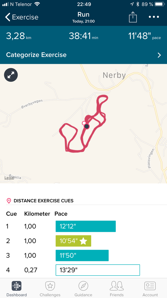

 I worked out with roller skis today with connected GPS.  This should have been 10-12 km but came out as only 3,28 km.  The path is plotted correctly but the distance is far off.  I think Fitbit has used the steps to calculate the distance even if GPS data was available.  I had this problem before also but it got solved but now it has returned. Probabley with one of the latest software updates. I loaded 2.53.1 for iPhone 2 days ago.

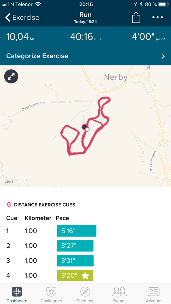

Today I made a run starting from the app. The duration was about the same as yesterday but now the distance was 10 km.  Compared to 3,3 km yesterday when starting from Charge 2. I think 10 km is about right. So the Fitbit people has messed up the connected GPS again with some of their updates using steps.  Both done with the same iPhone 6+. To measure distance with steps when cross country skiing makes no sense ...
Fitbit app's MobileRun uses GPS for distance.
Connected GPS on a Fitbit tracker uses "steps x stride" for distance, and GPS for maps
Ionic uses "steps x stride" along with using GPS to periodically update stride. This has been proven by starting run/hike/walk, and then driving in a car (distance = 0). Or start run/hike/walk and run in place, and you'll get distance of roughly steps x (0.5 x stride) because the Ionic assumes you are running and the GPS-stride-update algorithm refuses to set your stride to 0.
