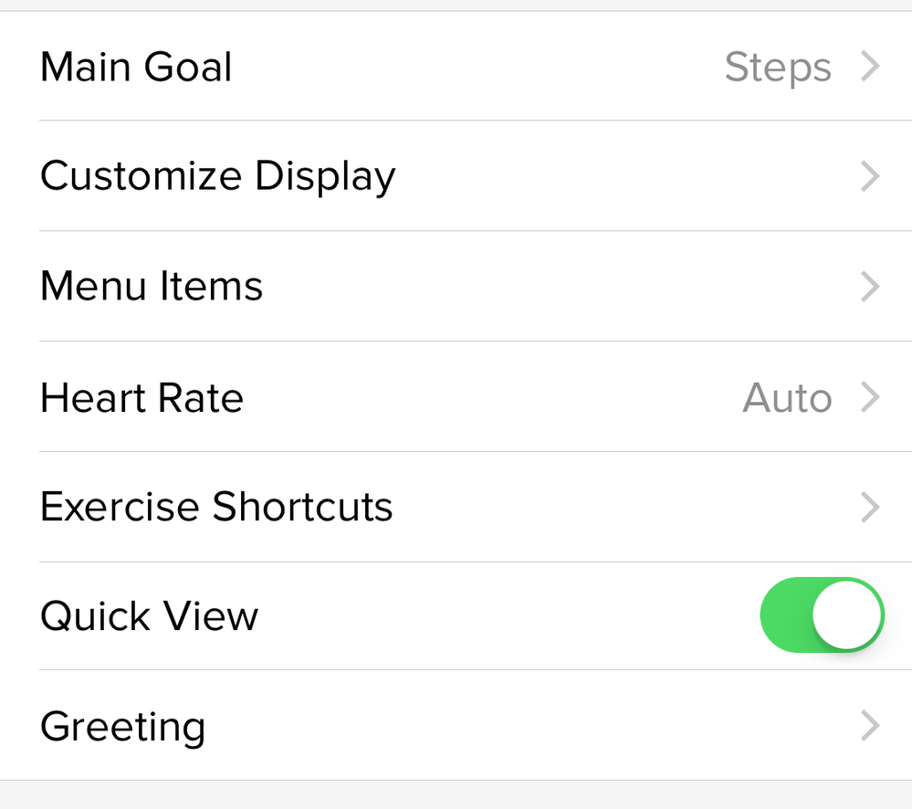

What is the difference between Quick View in app and Screen Awake (Left button)?  thanks
Hello @Baysidefish, I hope you're having a great day, thanks for taking the time to reply. Smiley Happy
The main difference between Quick View and Screen Awake is that Quick View is controlled by the app and can be enabled or disabled through here:QuickView.png
Screen Awake on the other hand, is controlled by the watch itself, which I personally find more convenient as you only need to press down the left button for a couple of seconds to access this setting.
I hope this resolves your inquire, if there's anything else I can do for you, please feel free to reply.
