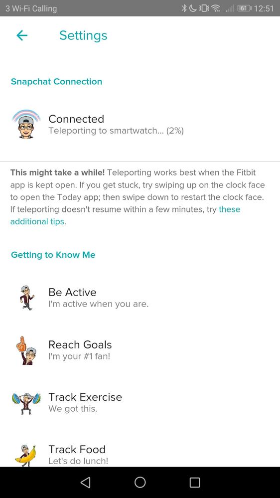

I got everything ready and connected my Fitbit to my snapchat/bitmoji. Now it is stuck at 0% teleporting. It has been stuck for over 30 min. I have turned my phone and device off then back on. I have a strong internet connection. My watch face just has the "thinking" circle on it now. Please help. The progress is still updating on the app so I know they are connected.

What worked for me (latest version of Android) was uninstalling the Fitbit app and re-installing it. It claims I have no internet connection on every other screen when using the clock face store now (I have to manually click the retry button for pages to load now), but the Bitmoji face finally goes past 2% on the install. Took about 20 minutes to go from 2 to 100% on the install.

My Versa wouldn't get past 2%, tried restarting the watch, the phone, toggling Bluetooth and it still wouldn't get past 2%. I uninstalled the Fitbit app and it has since moved to 23% now. Seems like uninstalling the Fitbit app works the best.

I'm still stuck at 2% and it had not moved in 3 days.

Mine is still stuck at 2% and hasn't moved no matter what I do. I've uninstalled and reinstalled everything, restarted everything and paired and unpaired everything. I'm totally at a loss as to why it won't work

I'm trying to use the Bitmoji clock face on My versa but it's stuck on 2% and has been for a good 3 Hours now - I have followed instructions on here by a few people and cleared cache etc yet nothing is working.
Can anyone help??

I have tried all the fixes and suggestions multiple times and am still unable to get past 2%. I have a samsung galaxy note 8 with android 9.0, reinstalled my fitbit app repeatedly and even made a new snapchat and bitmoji account. Been trying since yesterday and can't get past the 2% so I'm giving up. I'm really sad because I was very excited about this watchface. I guess I'll hope for an update that will fix it for me 🙂

@SarahMichelle82 Hey, there! Welcome to the Fitbit Community. If you are still troubleshooting and nothing else has worked yet then uninstalling the Fitbit app may do the trick. By deleting the app, none of your Fitbit data will get deleted. Everything in your Fitbit account will remain, but you might have to edit/adjust some of your preferred settings.
@7bebe2 @Dannys-Hart @jmacang8r Hello! I'm really sorry to hear you're all still getting stuck at 2% when teleporting the Bitmoji stickers. I've outlined our troubleshooting suggestions in this post, so please make sure everything has been covered.
If you've exhausted all these steps, please know our team is aware of this issue and we will continue monitoring the impact on customers. We really appreciate your cooperation and if there are any updates I will update this thread. Personally, I find sometimes you need to give things a break and just give it another try at a later time.

I had other bluetooth devices near by and mine still finally worked after uninstalling the Fitbit app.
My steps were..
1) shut down my Versa
2) shut down my phone - Galaxy S8+
3) Restarted my phone
4) turned off bluetooth
5) uninstalled Fitbit app
6) reinstalled Fitbit app
7) turned my Versa back on
😎 turned bluetooth back on (not positive if this prevented my devices from connecting right away)
9) downloaded a different clock face
10) installed the Bitmoji clock face
After all of that....it finally worked. Took about 15 - 20 minutes (30 minutes at the most) to do everything
I hope this helps someone

I was going to try reinstalling the app and noticed there was an update from April 1st. As soon as I updated the app oh, it worked instantly! I had tried all the troubleshooting prior and nothing was working. All good now 👍🏻
