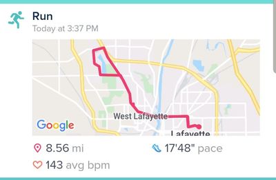

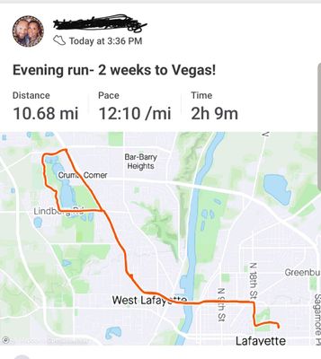

Here's an example of the differences from my Fitbit Versa and Strava app on the same run today- both were on my body with good GPS signal. I'm using a Samsung Galaxy S10+. GPS tracking on my Versa has historically been correct but after the last update for the Versa it hasn't been correct. I'm hoping Fitbit tech support can fix the bug and get us all back on track.

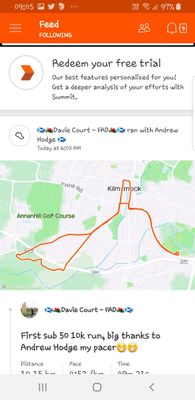

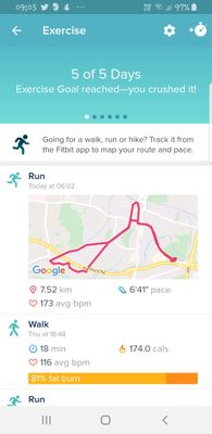

Yup its extremely annoying, theres one of my runs.
Best Answer11-04-2019 02:01
11-04-2019 02:01
10.15k on his watch and this is a race route that's been measured as 10k, fitbit 7.5k.

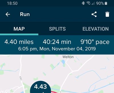

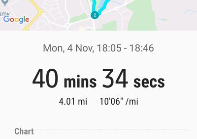

Got the new watch set it up and went out for a very wet run.
Went over distance by almost half a mile this time.
My fitbit
My Samsung using the same GPS
my wife's Fitbit Versa
not a fast run as its too muddy but my fitbit is still junk.
