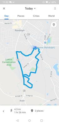

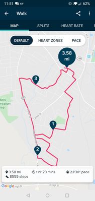

How can it be that the same lap is measured THAT wrong. It is 1,27 km difference which is BAD. Both lines run on the same road so it can not be just "difference". Step count is the same and also the time. Which one can I trust at all? It isn't the first time it has happened (at least once more).

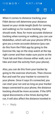

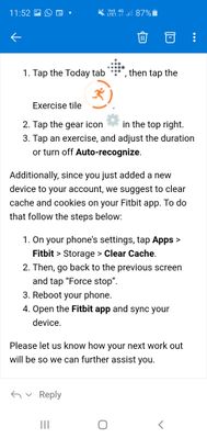

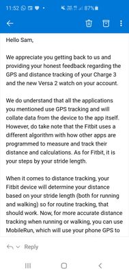

As I have mentioned, I have returned (being collected by DPD on Tuesday) mine and purchased a Garmin (arriving today) but got an email from Fitbit today which is more frustration.
From the email, it would seem they are admitting that the most accurate way is to use the exercise tile on the mobile app. In that case, it seems redundant to buy a watch on the first place.
I must add that I tried this last Thursday and the results were still wildly different from other applications.
They've given a very vague answer by saying that this is due to different algorithms but are failing to see that these are all from the same GPS signal.
I really can't understand why they aren't seeing our issue.
