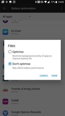

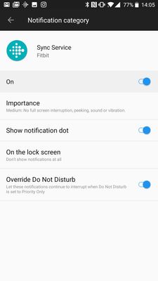

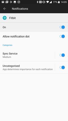

I've managed to get mine mostly stable by turning on all-day sync, plus the keep-alive widget. I've also disabled battery optimisation for the Fitbit and toggled the setting that allows it to run in the background (OnePlus 5 running Oreo 8.1). This configuration seems to work well, with notifications coming in very quickly compared to when my phone beeps.
When notifications stop working, I disable the keep-alive widget and that seems to get it to work again. I then enable the keep-alive widget a short time later.
Within the sync service (keep-alive widget) settings, there's an option to enable notifications even when Do Not Disturb is active. I can't say whether it fixes the issue that some people get, as my phone just goes to silent/vibrate when I want it quiet.
I've added some screenshots of the settings, but this will be slightly different depending on your phone.

Thanks for the screen shots. I'm not running Oreo yet but I was able to figure out where I needed to go.
I turned battery optimization off as well, so let's see what happens.
I noticed that I would need to force stop the Fitbit App and re-open it about a dozen times a day, otherwise after a while the notifications would stop coming.
Hopefully removing the battery optimization setting for the app will work. Let's see.

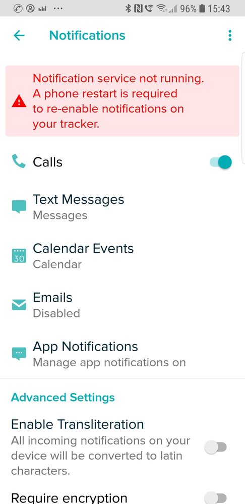

Yes having the same issue daily, only realizing notifications are not working when I get a message on my phone but not on my Versa. I have a Samsung Galaxy S8. Screenshot attached of the message on the Fitbit App when I go into notifications.

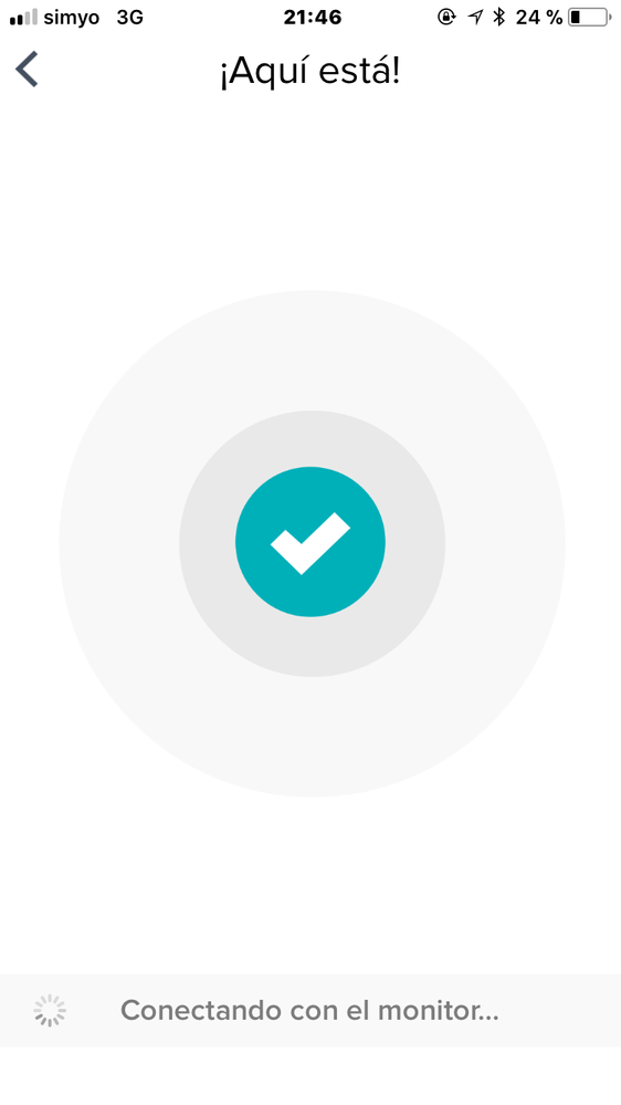

Since yesterday my device stopped synchronizing with the Fitbit application, and I no longer received the notifications on my fitbit Versa device, the application desists and now it does not connect with the monitor, I am very frustrated with these problems.
