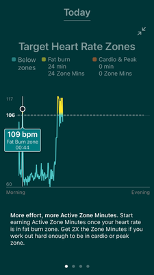

Hey
is anyone else experiencing huge heart rate inaccuracy during exercise with the sense?
During exercise with the sense it won’t ever get above 120bpm for me
but if I use my charge 4 during the EXACT same exercise my heart rate is between 145-170bpm in the cardio zone
It’s extremely disappointing and I don’t want to have to switch to my charge 4 everytime I exercise to ensure accurate heart rate
defeats the purpose of having the sense
seriously one of the most frustrating experiences I have ever had.

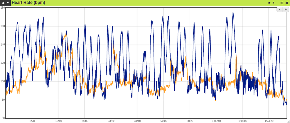

Just one more comparison. Bouldering session (indoor climbing). I took Sense first time to see how it would deal with this kind of activity. The pattern is simple. It's usually anaerobic activity (like weight training) with spikes during each climb and resting periods between climbs. Fitbit activity was tracked as regular "Workout".
Sense - orange, PolarH10 - blue. Looking at PolarH10, one can count spikes to tell how many times I have climbed. Sense is nowhere near that. This affected averages and AZM. Fitbit gave me 32AZM while it should give 79AZM. The avg. 103bpm, while it should be 119bpm. Again, I'm curious whether and how this will affect DRS.
