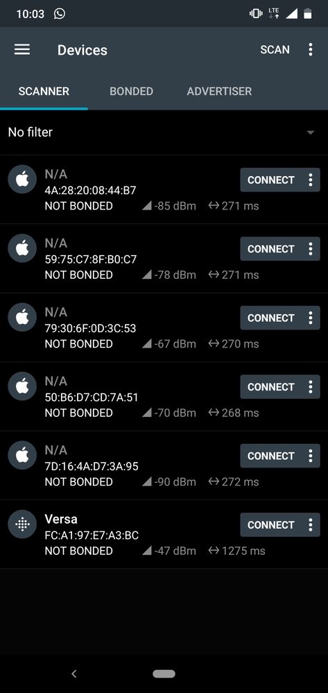

Seeing that Fibit hadn't come up with a definite solution, I'm posting this for those willing (and dare) to try something else.
My setup, a non special edition Versa and a U.S. version Nokia 7.1, same case here, everything worked on Oreo (8.0) and stopped doing so as it gets Pie (9.0).
First, in case you did the reset stuff and happened to unlink your device, you need to link it again to your account, you can use the Windows Fitbit app in a computer that has Bluetooth or another device that works, I sideloaded the Fitbit app on a Nvidia Shield and it worked pretty well, but you don't have to go that far.
Once your device appears in your Android Fitbit app (on your own phone), install and run the app from the first link, the second link is to show where I found it and it's a very long story I'm not going into details here, I can only tell that is from the official SIG Bluetooth network. Please note that this is highly technical application, so execute caution.
https://play.google.com/store/apps/details?id=no.nordicsemi.android.mcp&hl=en
https://blog.bluetooth.com/five-essential-tools-for-every-bluetooth-low-energy-developer
Open the app and stay on devices tab, locate your Fitbit device and hit connect, try to do this on a Bluetooth free environment it will really make it easy for you, I tried at home and was a bit surprised how many Bluetooth devices we have there.

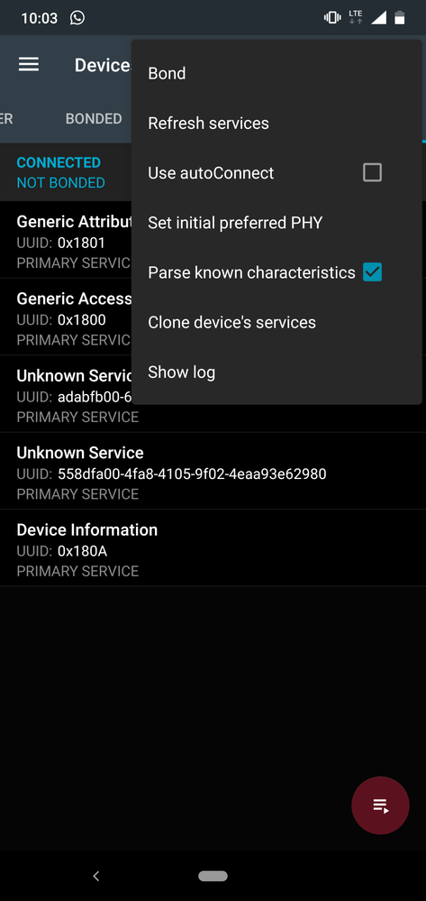

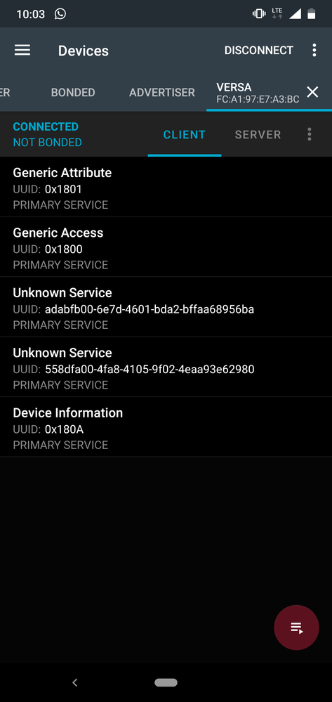

If it manage to connect, you're halfway through, a new tab appears at the very end of the tabs section and the app moves there automatically or just touch it to go there.
Be sure to be on that tab, hit the three dot button at the very top right of the app and a pop-up menu will appear, select Bond, it's actually the first item on that menu.

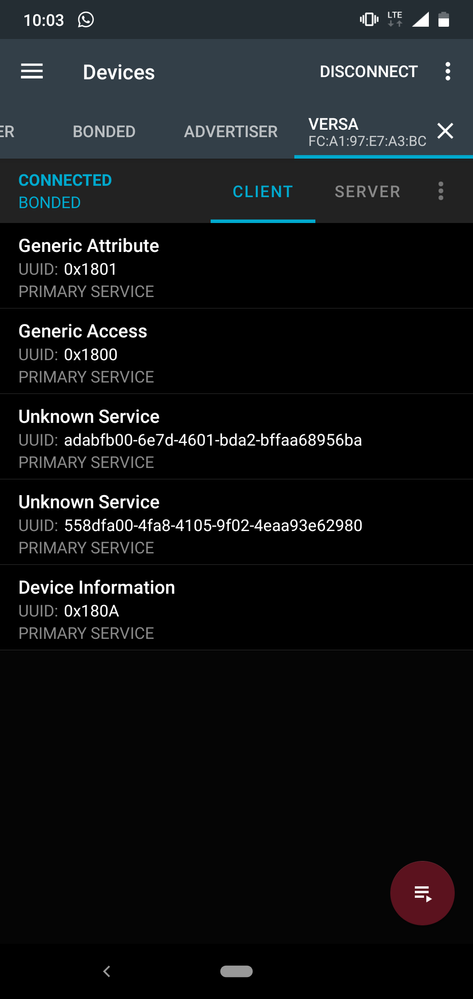

Now at the left of the screen a Text should say CONNECTED and BONDED. After I did this, I opened the Fitbit app and the device was already syncing and no error message was displayed. Waited for the sync to complete and then uninstalled the other app.
I have a little more than a month and everything is working flawlessly in either all day or manual sync. The only situation is when the devices get apart for too much time, I have to restart Bluetooth on the phone but this is something that even happened with my previous HTC phone on Oreo so I got used to it since they rarely get separated from each other.
Hope this helps anyone!
