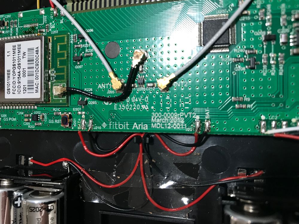

After years of working without fault, today my Aria failed to turn on when I tried to use it. Given it's been a few months since last use, I assumed some new batteries would fix the problem. No luck, though my Fitbit account said the last sync was only a week ago, and nothing had even touched it in that week. A quick google led me here which didn't provide any clear solutions.
Given it's long out of warranty with out any hope of replacement and since it looked most like a faulty connection, I decided to open it up and see, turns out its very straightforward to open without damaging, unlike so many electronic cases these days. Sure enough, one of the four wires coming from the batteries was disconnected. See in the attached picture:
Note left-most red wire is detached
I reconnected it and the scale powered up without problems. Now I just have to find a soldering gun to reattach it permanently.
As to how/why this happened, there are compression marks in the insulation of the four wires coming from the battery just below where they connect to the circuit board. In the picture you can see the indents from the reflection of the light of the flat areas.Looking at the inside of the back cover (removed to get access to the inside), there's a frame around the battery area that looks like it's what was pushing down on the wires. I'm assuming stepping on it put just enough pressure on that red wire to disconnect it.
Hope this helps someone else.
Note: Reposting this full description on the suggestion of one of the forum community council members who agreed it did not violate the guidelines, yet was removed without notification the first time.

@angusc I took it apart today and checked all the wires. All are intact. Nothing abnormal with the wires. Did notice that the GS1011MEE SOC wifi module showed signs of "rust" on the edge of chip not the leads themselves as this IC sits on a separate PCB that sits on the main PCB. I use my volt meter to verify I was getting 3V on both sides of the PCB. Something could have shortened out the Wifi module (although no signs of burn devices noticed). Thanks for your tip.
